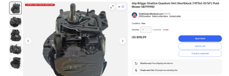

Unfortunately that has a 1" x 3-5/32" shaft
Small Engine Warehouse says they don't have any short blocks that meet those specs.

I can buy a new short block (sb799982) for that engine for under $100, then I can buy a NOS crank for under $100. Am I crazy to swap a crank on a brand new engine ?
Or should I just buy a Predator ?
