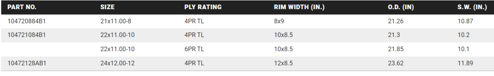

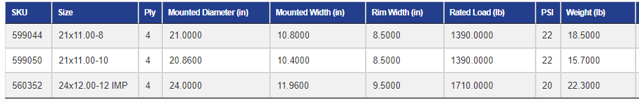

Wondering if anyone out there has the Carlisle AT101's installed on a 48" Radius E? Between the sliding and loading up with mud, I absolutely despise the factory Hoosier turf tires. I have been researching bar style tires, and am having difficulty finding a "like for like" size option. Current tires are 22x9.5-12. I went to my local tire shop, and they were less than helpful. I am a bit confused and would greatly appreciate some help. Would any of the options below fit? I have 1.75" from top of factory tire to fender components, and .75" from inside tire wall to frame. If anyone has any other tire recommendations or guidance, I would appreciate it!
AT 101 size options:
Kenda K472 options:
