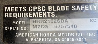

I have an older Honda Harmony II (HRR216K2). I'm trying to replace the drive belt myself and am running into problems. I've looked at lots of videos online but don't see any examples that show my particular model and what I am dealing with. Most instructions refer to unhooking a spring to enable the transmission to swing and attach the belt or remove a belt guide. Mine has neither. The transmission housing on mine is attached to a bolt with a spring on it and I can't see how to disconnect or otherwise loosen the transmission housing to attach the belt. I'm attaching a few photos showing what I am dealing with. Any tip are greatly appreciated.

Complete your Model Number please, example SXA, HRX, etc.

I have a replacement belt and have watched all the videos on replacing the belt but none seem to show the exact model I have.
