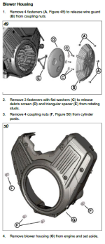

First time poster hoping for some expert advice.
I believe that I've sheared a woodroof key on the flywheel, I have spark, fuel and compression so timing is the only wildcard at the moment.
I'm hoping for some advice or instruction on how to remove the darn plastic flywheel shroud so I can pull the flywheel and verify. There seems to be some sort of bolts/pins/thingamobobs on the lower portion of the plastic fan cover/shroud and I can't figure out what they are or how to remove them! I can't see them, my old fingers don't recognize them as a bolt etc. I can't see them and I really don't want to start breaking things but my frustration is getting me close...
I can't lay my hands on an inspection mirror at the moment and I'm pulling my hair out, any info/assistance is greatly appreciated!

Check out items 1212 and 1335 from this diagram. Looks like a stud with a nut to hold the housing on.

Thank you both so much!
You are correct, I pulled a variety of other parts & pieces off and was able to see them. There are 2 plastic protrusions on either side of the housing, I could see/feel those and I thought they were connection points but they are not.
