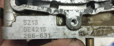

What are the numbers dot marked in the top of your housing near the fuel inlet tube?

Thanks for your reply. I've attached an image of the id numbers.

Well, as it turns out I have only one match. It is a steel bowl aftermarket carburetor (The bowl may not be correct for the application). It has the white center plastic section with 2-screws to retain it, and the jets are held in with tiny O-rings.
My jet drills show the right (on the idle stop adjust screw side) to be a .0460 and the left to be a snug .0465. This carburetor I have was from a 23HP which should not be far off.

thanks again for your investigation and reporting. The jets I purchased were for a 24hp B&S engine and are very similar to those you report. My 27hp Generac isn't happy with these, just a bit lean. I think I will carefully open them up to obtain the performance this engine is capable of.
