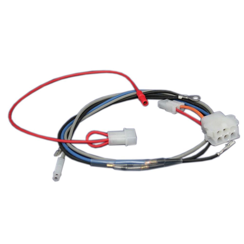

Engine side wiring harness. The middle wire that splits in 2 and goes to each coil. Right where the wire splits into 2 black wires there were /( is ) two little components. Can anyone tell me what they were/are. They look like diodes in one photo and in another they look like resistors. Does anyone have one they could look at and let me know?
Or does anyone have a electrical diagram that shows the components? The wiring diagram only shows a split but does not give any details.
Thanks in advance for your time.
I can tell you that at 15 feet away you can hear this part sizzle before it disintegrates...:frown:
http://s.sears.com/is/image/Sears/PD_0071_500_696576?op_sharpen=1&qlt=100
Sorry, this is a picture of the harness.
