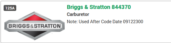

B&S vanguard 23hp 386777-0111-e1 05113011.

Original Carb NLA use 844370

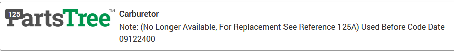

And you won't find the older number as Briggs has removed it. Read the part note for item 125. It basically telling you to use item 125A. Same on the PowerPortal IPL.
And it can be either one of the superseded PNs listed.
