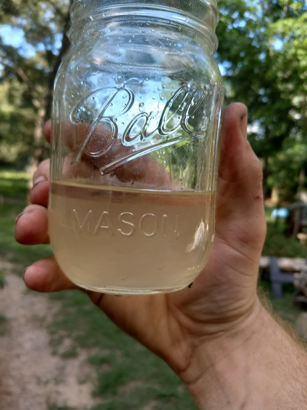

I test my 100% gas once in a while.. Easy to do.. Get small vial w/cap, add 1 inch of water & mark that level, then add 3 parts gas. shake & let sit, ..
100% gas will not increase the water level above the 1" mark, if it does like pics, it is E-10 or more...
I do that same test on the 'No ethanol added' fuel I buy at my local station that sells OPE fuel.
