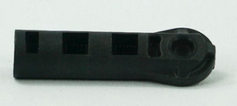

My Murray select shifter has broken. It's a plastic turn buckle. Local shop was no help. Transmission lever has f-n-r,the adjustable turnbuckle has broken.
Product # 960440008
Model #MS18542.

Its the missing push that will be the problem as Husqvarna doesn't supply it any more. 1/4" Push Nut.

Thanks but I need the turnbuckle that hooks the shift lever arm to the transmission arm. It's a plastic piece

Go get some alert pill or a strong cup of Java, put the brain in gear and think about it. PN GT34100. It is the push nut that is another piece you will need. I have to order 200 of them just get the one I need here.
Unless this is not what you are looking for.
And no it is not listed on the IPLs as they are wanting you to buy the whole fiction pack. They got enough push back from the equipment OEMs they had to make it available.

Thank you StarTech, I need the push nut also. I was looking for the sleeve/rod connector. Thank you for the part number!!
