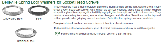

You probably will need the following lock washers. You need #10 / M5 versions

I ordered 5 of them. I also heard from Stihl and they are saying once the bolts are torqued once then then will not hold anymore.(?). Which is strange since it two occasions I used one new bolt and one old bolt and both cam loose. Not too sure of the torquing story with my experience with new bolts.
Also Sthil did not provide the torque specification. I doubt it can be too high since it is a T-27 sockethead bolt. I twisted a T15 driver in two pieces tying to torque it on my automobile engine intake manifold bolts.
