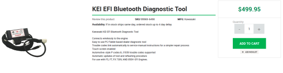

I think I read there are 7 sensors on the EFI engines, and there really is no way to check them without the software. I didn't know if there was anything else I could check on the engine.
Naw, haven't yet. 2 3/4" - 3" is kinda standard cutting height here. Lots of centipede grass and most like it short, some down to 2 1/2". It does ok that short. But planning on taking mower to dealer next week after the first and let them connect to computer. Engine is EFI, and I think I read where it is a wireless connection. Of course, they will charge me for an hours worth of work for a 10 minute thing. But hey, that's ok. They have a lot more overhead than me.did you ever get this issue figured out. 3-1/2" - 4" is not high at all, that's pretty much my standard cutting height.... if I'm gone for a month I'll have to cut anywhere from 9" - 12" and only have to slow down my speed too about 1/2 - 2/3rds normal speed.
