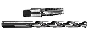

But, my mower's transmission are "non-servicable" from the factory (I suppose they want you to take it to the dealer). They do however have a port on top and the fix some are doing is taking their mower apart so they can get the transmissions out, turn then upside down to drain them so they can put in new transmission fluid. This is so stupid, I could not bring myself to consider that... I knew there had to be another option.
So, I found the video posted down below of a guy who explains how his was also giving him trouble and he simply drilled a hole in the bottom, cut some threads in the hole, and install drain plugs. A very simple and easy fix... just don't run the drill bit up into the housing as there is supposed to be some "non-servicable" filter on the other side and if punctured it could cause issues with fluid pressure potentially.
So, here's all the items I bought to install drain plugs
so I can easily service my transmissions in the future.
Century Drill & Tool 93201 1/8-27 NPT Tap and 21/64" Drill Combo Pack
Stainless Steel Outer Hex Thread Socket Pipe Plug Fitting 1/8" NPT Male
Permatex 80062 High Tack Gasket Sealant (put this ion the threads to make sure there are no leaks)
Amsoil 20W-50 Synthetic Hydrostatic Transmission Fluid (the good stuff!)
