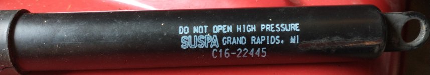

So... I pulled it apart and this is what I found. Anyone else see a problem here... Haha!
The person that owned this previously used a part to hold a window open on a hatchback (or something) this explains the arm pushing forward.
Hope this helps someone else.
