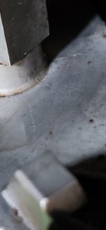

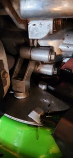

I did a quick cleaning of it... it was filthy... and that might have helped... But I noticed a new and worse issue now.. So while I was cleaning the entire mower, I cleaned off all the dust and gunk on the aluminum part where the engine bolts to the deck and after I got it running again I noticed it seemed like it was smoking a bit from under the deck or near. So I stop the mower and get a light and look where I had just cleaned to shiny aluminum and it looked like liquid on it. So I wiped it off again and started the mower and clamped it to keep it running and got down with my light again... I could literally see I guess fuel droplets and it looked like they were coming out of the aluminum to the right of the muffler. So I am guessing something is cracked as I can't figure out where fuel would be coming from in that area..

That first one is a close up of the second pic.. It looks like a bead of fuel comes up right above that second line/crack in the aluminum.. The second pic shows it leaking down the deck..

Those cracks you are seeing are casting marks, not cracks. If this came to my with your symptoms I would be giving the unit a good hot pressure wash to remove every bit of dirt or oil I could see. Next I would make sure everything is dry without running the unit. Next I use an old farmers trick to find oil leaks. I coat all areas I suspect to be leaking with a light powder, as in flour, foot or body. Next I run the engine until hot, then shut it down and look for signs of an oil leak. You may have to do this two or three times. I suspect the leak may be the sump gasket. If nothing shows up clean all powder off with the pressure washer, use the unit until you find leaks and start over.. I understand this may take time, but I hate to tear into something until I have an idea of what I’m looking for.
