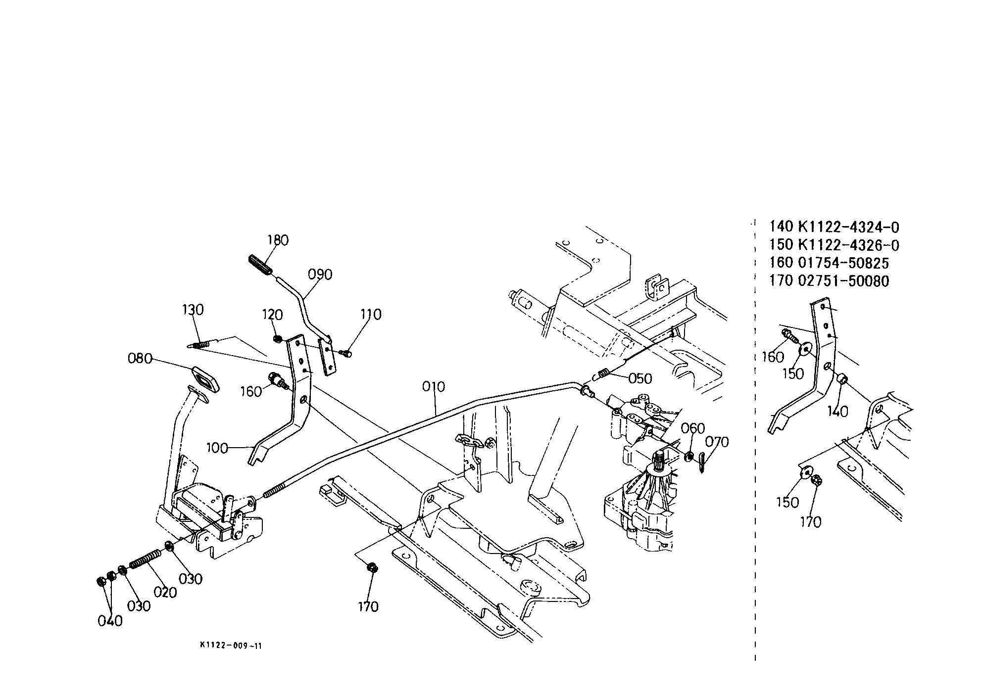

got the new coil today and that fixed the motor it runs great. but now the trans started leaking out the bottom, its about even with where the brake leaver hooks up. looks like some type of vent or something. its about a one inch by 1/2 in and has 2 ribs going across. anyone know anything about this. thanks
