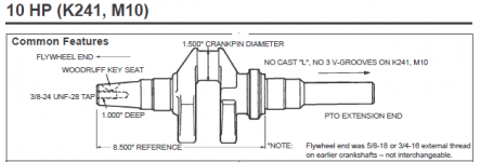

Does anyone know what the crankshaft rod journal size is on a K241. My friend broke the rod on his welder and after cleaning all the crap aluminum off it mikes 1.5/1.498. All i can find for new rods are standard, 010, and 020 under. I'm hoping I can get by with a standard rod as crankshafts are almost non existant.

Here You can download a free service manual for Your K241
120
12,873
The info requested is not in the service manual.

It sure was.
