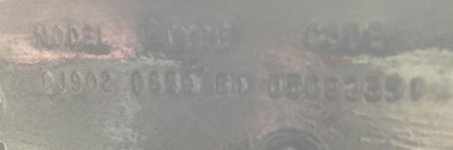

I have two push mowers made in 1992 and 2005 that have the old B&S Classic 3.5 HP engine. My last ignition coil finally failed, and after a dozen hours of searching I can't find a part number. Not even B&S seems to know these engines existed, although millions of them were built. The engine models are 95902 and 91902, the bolt spacing is 2.5" and the flywheel is 5.75". I bought a coil online that looked identical, but it turned out to be for a larger flywheel and the gap is too large to get a spark.
