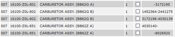

First determine model using the model code GJAEA which is GCV160A then using the type number S3A to narrow the spec. Then you get this on the Honda site
Using this table look the carburetor for the BB #s but most likely it will the 16100-Z0L-801 carburetor NLA. Should be able to sub the 16100-Z0L-802.
From one my vendors this is what they are have listed for your serial #

That is a GCV160A engine that calls for the 16100-Z0L-853 carb
The peparts site only goes back like 10 years. prior to that can be looked up by the dealers on the internal dealer site.

changing the first number of my s/n from 2 to 3, I at least stopped getting "serial number not found" and it showed the 16100-Z0L-853 as the carb.
Is the "BB" number on the carb?
I've had it off at least 5 times and never noticed it

Yes.
And IL I never gotten the IPL look up to work by entering the serial, just the model and my wits which are not much. Looking for a brain upgrade but I keep telling they haven't been invented yet...
