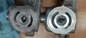

  • / Hydro Gear spins backwards after new center section and seals... puzzled
Definitely a difference in the center where the fluid passages are located. Right is the replacement part-left original..
