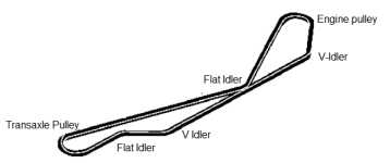

Im working on a Husqvarna GTH 2654 changing the transmission drive belt and am having trouble finding the right replacement and route diagram. I looked the belt up through Husqvarna and the site claims the belt is obsolete and doesn't give any description of it. I measured the old belt and it was 82 inches, i ordered one on amazon the claimed it was the right one being 82 1/2 inches long. When I try to put it on i just cant make it work no matter how hard i try. it shouldnt be this difficult. if anyone has a belt diagram or the actual size or something to point me in the right direction it would be GREATLY appreciated!

GTH 2654 with Hydro Geaar transaxle
532161597 belt 1/2 x 82-5/8 and it is not NLA. Back of belt goes to flat idler and inside of belt to the v-idlers.
The GTH 2654T use a 1/2 x 92.40 belt so that not going fit. And it has a Tuff Torq K46 transaxle.
