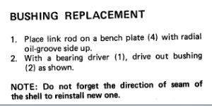

Do these bearings press fit, into link rod? Probably need a hyd press or maybe just a vice? Or do I stake them in at the edges?
Thank you for any advice?
