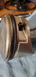

I got a new piston and ring set for my lawn mower and I'm having a little trouble with the rings. There are 3 grooves in the piston and the bottom groove is for what I guess is called the oil ring. It consists of one solid ring plus 1 corrugated looking ring plus another solid ring like a sandwich. On the old piston all 3 of those rings fit in the lower groove but with the new piston only 2 of the 3 rings will fit.The corrugated ring is thick so that the upper ring kind of sits on top of it instead of in the groove. See photo maybe hard to tell. Is this OK?
Note that I am not talking about the other 2 rings that fit in the middle and upper grooves of the piston. Those are fine.

I removed the rings from the old piston (oil rings) and they are difficult to get back in, too.
There are some videos about this but none talk about what I'm seeing. I'm pretty sure I have the right parts. The 2 oil rings look identical in every way

Sorry guys false alarm. I found a very high quality close up video and I immediately knew my problem. I did not put a nice long bead of oil into the groove before putting the rings in. What was impossible without oil became very easy. Lesson learned. I appreciate everybody taking the time to help me out.
