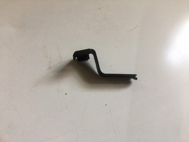

I was greasing the shaft on my weedeater and this thing popped out of the handle somewhere. I can't find a diagram online anywhere. Does anyone know where it goes?

Shaft retainer clip. Goes in under the shaft where it slides into the starter housing. It is held in by the shaft clamping screw. If we had the model number we could probably pull it up on a diagram.
Item 34 in this diagram
There was an issue with the shaft sliding out of the clamping area of the starter housing, so that spring clip locks the shaft into the housing
