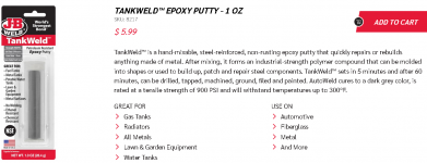

Those 5 minute jobs are weak. Stay away from them if possible. Look for the old 24 hour cure stuff.
JB Stick Weld says steel then any metal?? It's also a 5 minute set 1 hour cure. 900psi
Of the sticks I would get the Tank Weld. Made for gas tanks and states lawn and garden equipment.

Slomo, the TankWeld is the type of product I was referring to. Ill look for the Tankweld type.
Sorry, I did not remember what it was called but i did see it before so Scrub reminded me of it.
I was also looking around to cut off the bent threads and found gas tank cap and bung - don't ask, i learned this phrase looking(bevis and butthead Bungholio....) I'll look into the glue idea first.
