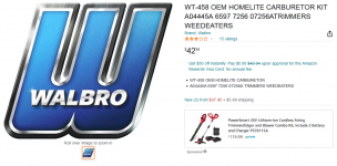

Remove the carburetor and looking the Walbro model numbers. From there post them and someone should be able to look up the carburetor and give the correct kit numbers.
But is likely a WT-458-1 (WT-458A) which uses the D20-WAT gasket and diagram kit or the K20-WAT carburetor repair kit.

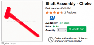

Then how does it control the engine speed?
And btw the way according to the following it does have both a throttle vane (butterfly) and a Choke vane (butterfly).
And carburetor is still available from Walbro.
and choke shaft itself is available.
If you remove the choke shaft there is usually a steel ball and spring that detent the choke shaft.

An older Walbro carburetor. I had a few of them. Still uses a spring and ball to lock it in place and brass shaft will wear out the dimples.
