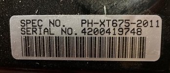

Is this pulley available without the Transmission?

Well in this case the engine model/spec is not going to help as it is not an engine part. Need the mower model number at least. With that said the pulley may not be available separately from the transaxle; won't know until we can look up the mower.
blaster 2023
Serial# 4200419748 other numbers: 21038 20371
R
Short answer NO. In my experience I’ve never had to replace that 2 piece pulley. Why do you want to replace it?

That transmission is not for the Toro model 20371 you posted. You have a single piece pulley and the model you posted has a two piece pulley. 21038 is not a good Toro model number. Something does not make sense.

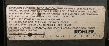

When I returned home I checked the belt that is about 1/4" wide and slipping. I am waiting for a new belt. While working on it I found a chinese gasket and a bread tie for a bolt and fishing line connecting the drive cable to the handle. someone may have changed the transmission assembly.Spec.jpgEngine1.jpgSticke2.jpg
The engine serial confirms it is a 2012 model.
