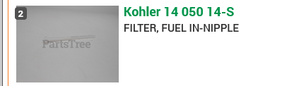

if its a XT775, there is a filter in the tank
