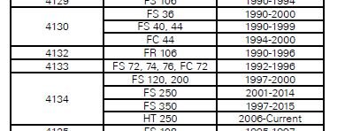

Thanks Startech, I did take off the spark arrester and burned off the carbon, reinstalled it and it fired up. I also put a new spark plug in it. Does this model not have screen on the spark arrester? There was no screen. Any idea how old the FS74 is? My father in law gave this one to me when we cleaned out his barn.
Cmoore
Mar 24, 2024
Thanks Fish, looks like I'm trimming with an antique. I'll try to keep it going for a while longer.

Yeah, it was an oddball series that never really took off, I rarely see any around here. Hard to find parts for.
