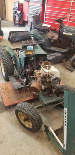

Here is my latest PITA project. It is a fairly rare Hunter. They were made locally on hunter ave in Dayton ohio. A guy collects stuff like this. I get to bring it back to life. He was assured from the guy he bought it from that it runs. Well that was BS. Wiring hacked up as well as all the linkages and stuff in a box they took off plus no documentation. Hunter.pngThis is the third one like this he has brought me. He pays well and never questions the bill.
