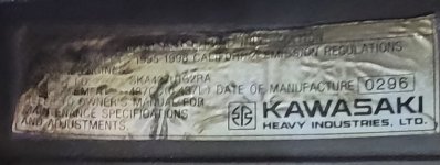

For some reason, this fan (just below the radiator) had one fin that had dropped down, like it got hot. And was rubbing on the fan shroud. All the others were fine. No drooping at all. So I heated it up and bent it back up, so it wouldn't hit.
Question is, is this going to work? I didn't heat it up enough to burn the plastic. I kept my finger wedged under it while heating, until I felt it give. Then held it in place until it cooled.
Here the fan blade.

No downside to anything you've done, It may happen again since it's been bent once already.

Check air flow from the fan down and beyond to across the head and spark plug . Sometimes there is a restriction between engine and shroud .

Who’s to say whether it will work long term. What caused the warpage in the first place and could the plastic be fatigued enough. Hard to say. A fan blade breaking is not unheard of. If it were my 28 y/o engine, I wouldn’t take the chance. A replacement fan is much cheaper than a radiator.
11,424
Comments like this happen when commenters don't bother to look up the engines or know what they are talking about. This is a water cooled engine. The fan damage is from over heating, most likely the engine has been ran low on water or has a clogged radiator; so I would make sure the radiator fins are all clear as the air is usually drawn in thru the radiator and blown out the air duct. Usually there is a screen place over the radiator but dirt and dust still can clog it. Clogged cooling radiator fins can cause a lot extra heat as air flow is highly restricted.
I did a Walker Stand on mower last year that the hydraulic radiator was clogged with dirt. On this setup the radiator is directly over the engine cooling fan. With it clogged the engine fan and shroud both melted they stuck together.
And the 59041-2063 fan is listed at $40, but going rate seems to be $45.

So how is the blade balance now? Rubbing can remove material. Bending blades can change things as well.
