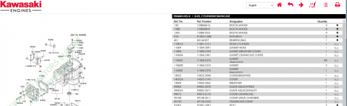

Thanks for the info guys. This is the engine I'm working with.
I remember checking a year ago and I saw the gasket was no longer available but it now looks like I can buy it.
11060A
110602481
GASKET,CRANKCASE COVE
They also have the seal.
92049C
920492227
Oil Seal
I will measure the best I can with my feeler gauge before I remove the case to verify the .5mm recessed seal.
I'm not seeing any shims in the link above.
Any other thing that you think I should replace when I have the crankcase open?
TIA

  • / exmark metro 36 fb-460v kawasaki engine leaking around crankcase gasket
Hopefully they have some in stock as Kawasaki is listing the crankcase as NLA.
