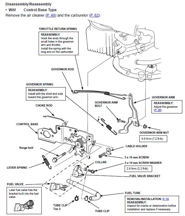

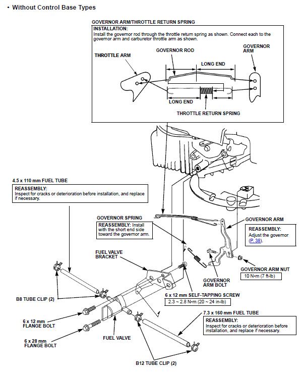

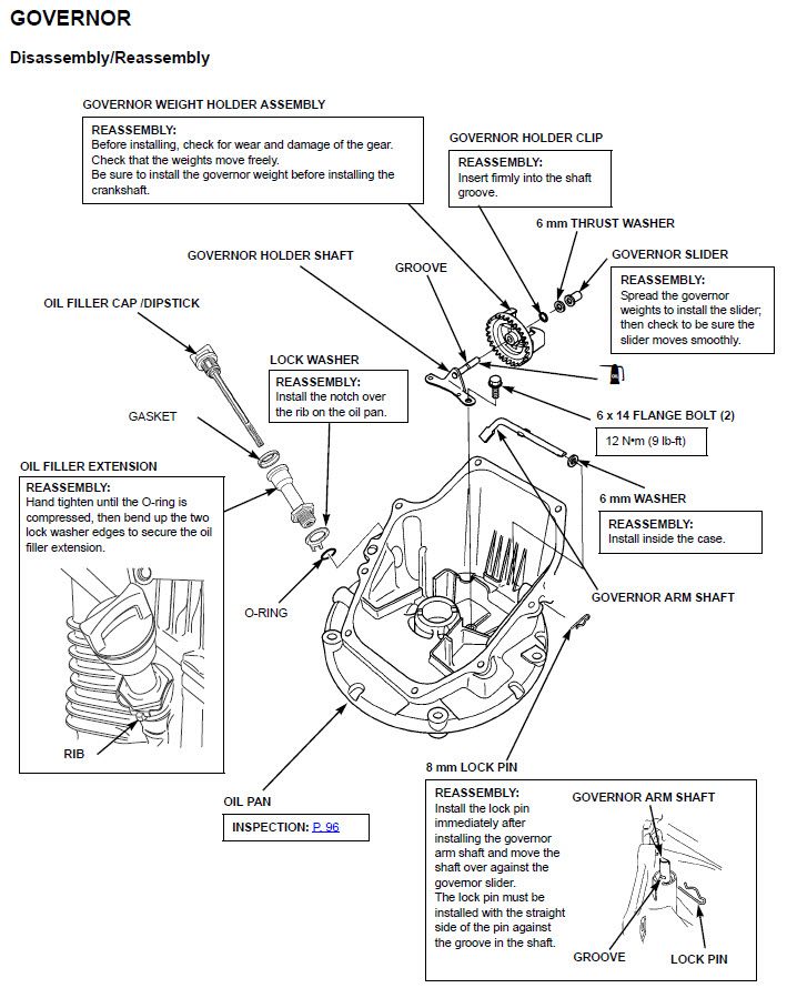

Some models of that engine have a control base, others do not. Here are some pages from a shop manual that should help:

Thanks, that helps a bunch. So now I can see its the governor arm shaft that I'm wondering about. It appears from the diagram that the paddle on the end of it would go down rather than horizontal. I'm thinking I must have installed it right, so not sure at this point why it's not kicking the engine RPMs down. Perhaps the governor slider isn't sliding freely. Looks like I may be dissecting it again.
