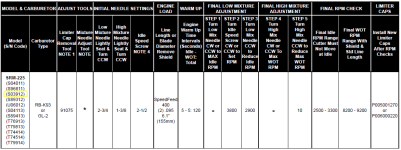

What is the first of part of serial number (letter and 5 digits)? With I can look up what the Max RPM should be closed to.
Some versions are 8200-9200 rpm and others are 9300-10800. Also the string length is different among the different models depending on the serial. All version is tested with a Speed Feed 400 head.

The SRM-225 Serial number is S03912303806
If I get the Max RPM how can I test or check that? I would also assume it is with the string being a particular length? This has 4 strings hanging out.
