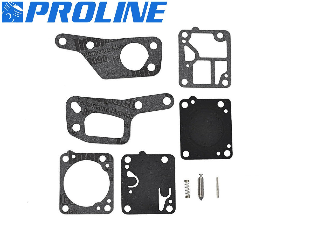

If possible, I'd like to locate complete carburetor, but I haven't had any luck,except for rebuild kits, so if there is a good rebuild kit someone would recommend, all im finding is chinese jobs.. Any Info is helpful. Any other tips on the chainsaw will be appreciated too

From my investigation your carb has a Husqvarna part number of 538408201, but is only available in Europe. This is why you won’t find it available in the US. My suggestion is to contact Husqvarna directly or the distributor you obtain your Husqvarna parts from.

The repair kit you looking is a Zama RB-19 which they obsoleted as the distributors are no longer listing it. But you can pick up an aftermarket kit from Amazon.
or you get two kit from e Bay.
Or you can get one from Sawzilla.
Thank ya sir.
