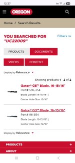

Having issue replacing OEM blades with Oregon gators. Although gators should match according to model numbers provided, blades do not clear properly. Could this be an issue at the spindle or the blade hole? Help!

John Deere lists UC22009 as the replacement blade part number.
These are the only blades Oregon lists that cross to the Joh Deere UC22009.

Yes, you could have a spindle problem.
Do the left and right blades both make contact with the center blade?
Does your deck show any deformation around the spindles?
