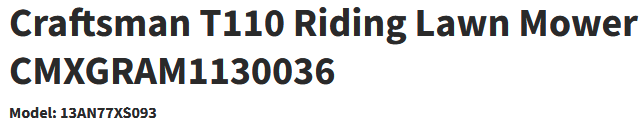

I just people would get it thru their heads that we need the real model numbers instead of the layman mower hood model.

Thanks for the info. I’ll check it out and see if that all seems good.
“I just people would get it thru their heads that we need the real model numbers instead of the layman mower hood model.”
-Sorry. I’ve never been a lawnmower forums before.
