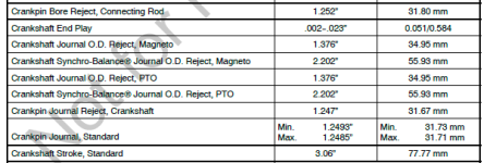

Hi Help needed identifying the correct con rod & gaskets
for a brigs & Stratton 13 hp vertical engine, model n0 28S777 type 1142-E1 code 980304ZD. There seem to be several options ! 692420 494504s 495490 , I also can’t tell if they come with the bolts ? It says 28 ohv on one side ! I am not very good with numbers so if someone could give me the correct part n0 it would be much appreciated, thanks in advance .Tim
118
12,660
You need to mic to the crank pin.
You have for your date code two choices.
494504S standard connecting rod.
495490 0.020 undersized connecting rod.
