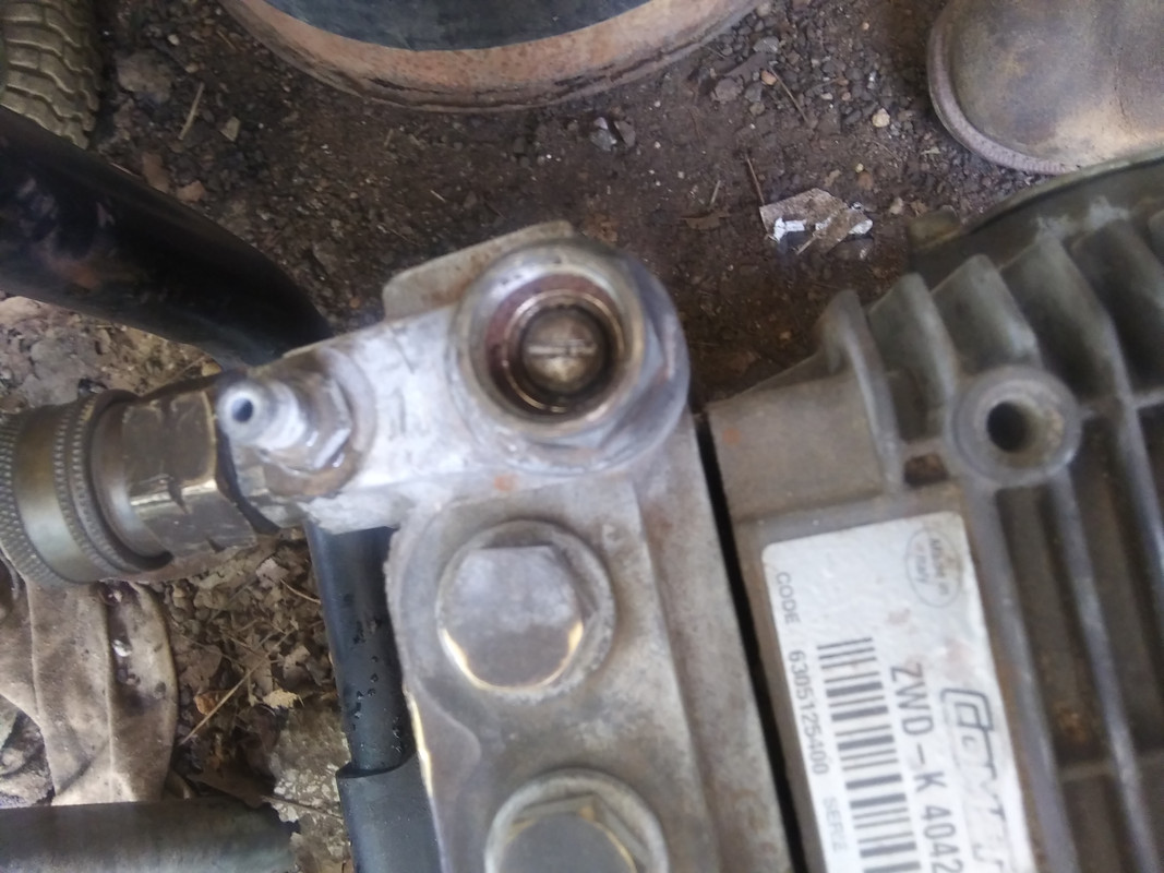

and here's what i did this morning, i removed the assembly that is under cap #91, unscrewed it from the pump (assuming it is the unloader, parts list doesn't call it that) (that regulates the pressure), it was very stiff to move and sticky, i reinstalled it and left the cap #91 and the spring off, just revealing the flat head screw, with the pump running, whenever i would press that screw down it would build *some* pressure....nowhere near the 4000 psi though.
Pics
similar pump, mine's a 4042. so that is the unloader...
