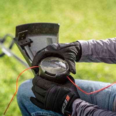

Gentlemen, I've got the motor running fine Clockwise. According to the info I obtained, the only mechanical issue that must be completed now is to alter the head adapter so that it will not unscrew, I intend to drill and add a small roll pin. Turning around the line cuter will make it work. One may also want to alter the debris shield dependent on how it flys. You can see the wiring changes in the picture. Two of the primary wires (red & black) are swapped. Also, two of the sensor wires (blue and yellow) are swapped. All of which were easily removed from connectors and reinserted. It is said that some of the brushless machines have different color wires so some trial and error may be necessary to find the correct combination. I'll pick up and Echo Speed Feed 400 tomorrow (Thank you Tonebalone) and see just how this thing will works. If anyone has questions or would like more details please send me an email, add your number and we can discuss. Cheers, Ray [email protected]
