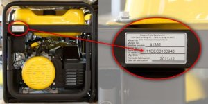

Can you post the model number of the unit please. it should be located on the frame.
