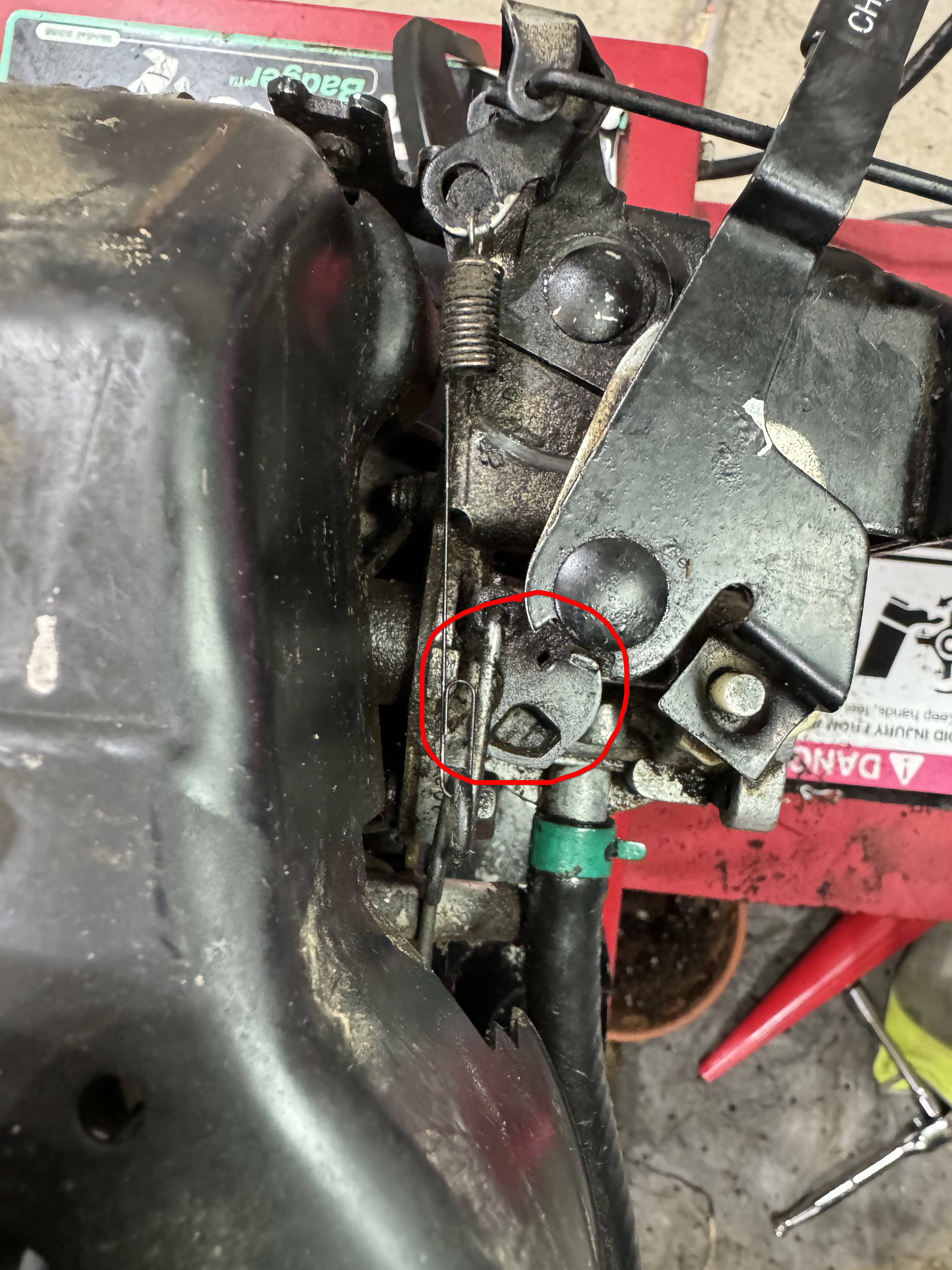

I have a B&G series 650 model number 124T02-0120-B1 on a roto-tiller. The engine starts then stops. I have removed the card and in the process of cleaning it.
I noticed a linkage piece not moving when opening and closing the throttle. Any suggestions on why this isn't shifting back when moving the throttle back and forth and also suggestions on how to fix this?

It stays in wide open position except when the engine is running. Then it governed.

So it isn't supposed to move back and forth when I cycle the throttle lever?

Correct it only moves when the governor pushes it toward idle position to regulate the engine speed; otherwise, the spring hold it at wide open until the engine is running.
