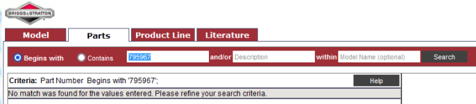

I'm looking for a replacement NIKKI carb original part number is 795967 does
anyone know where i can find a replacement part number
11,476
If you are lucky that base in house carburetor PN is translated right to the 796227 carburetor.
However it is best to go by the Briggs model, type, and date code when looking up parts; otherwise, you are just taking a huge chance that get the right carburetor setup.
795967 is not a valid Briggs PN outside their internal system.
