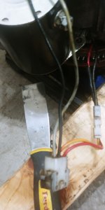

On the original engine there is a connector with a black and white which goes to the carb. Then there is a black and red going to the alternator. The connector from the mower has it in the connector as orange and red. The new engine only has a yellow going to a block with a red exiting the block. The black is grounded on the black box on the engine. Easy to splice the black/grey to the connector and the red from the connector to the red on the engine but where do I connect the black wire from the connector to the engine?

The black and grey wires from the old engine can be connected to the corresponding grey and black in the double connector on the new engine. The grey is battery power to the fuel solenoid on the carb and will be powered with the key in the on and start positions. The black is the kill wire for the ignition module. That wire is grounded in the key off and open in the key on. That wire can never see battery voltage unless you want to replace the ignition on the new engine. The red and orance can be spliced together and connected to the single red connector coming from the square box aka voltage regulator. And if the mower doesn't have headlights or you don't care then you just need to connect the red to the single red on the box and ignore the orange.
