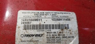

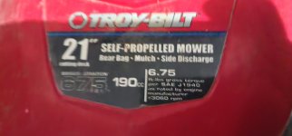

I have attached pictures of the engine info and mower info labels if that helps.

2007 model but we need the model and type numbers off the engine. The layman model doesn't help us and I haven't even of a 975 series. But label shown is a 675 series.
With this it appears to be a L head (side valve) engine and with the age it is possible the valve clearance have closed up to a point that there is little compression time for the fuel to ignite.
