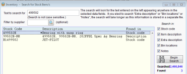

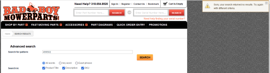

At 200 hours, routine maintenance has found a spindle and a ZT front wheel bearing that need help. I am familiar with the current rubber shielded bearings. And I'm assuming that the ZZ designation has double metal shielding. If the shields are removed, one can see the bearings ... that ain't sealed. I know at some point in the past, really sealed sealed brgs were out there. What would ID a really sealed brg?
For ref, the spindle brg is a 6305. the wheel brg is 499502. Thanks
