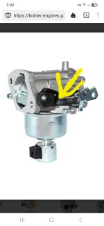

Looks like time to shop at Ebay. Just make sure you study the design you have and match it, because choke shafts are often different.
I ordered a new OE carburetor through the dealership. I will pick it up tomorrow. They also had the OE choke kit. I will likely get that as well and repair the existing carburetor. You never know when you might need a spare.
MParr
Jul 2, 2021
9
1,999
New carburetor is on. Choke and throttle cables adjusted.
It's running great.
