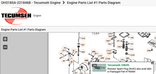

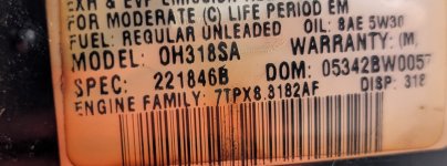

I'm having trouble finding the correct spark plug for my 9.5 horsepower Tecumseh snow King. The one that's currently installed has a thread length of 3/4 of an inch Aunt. Everything else I could find says it should be only half inch

I’m finding that your engine uses a Champion RN4C, which has a 3/4” reach.
