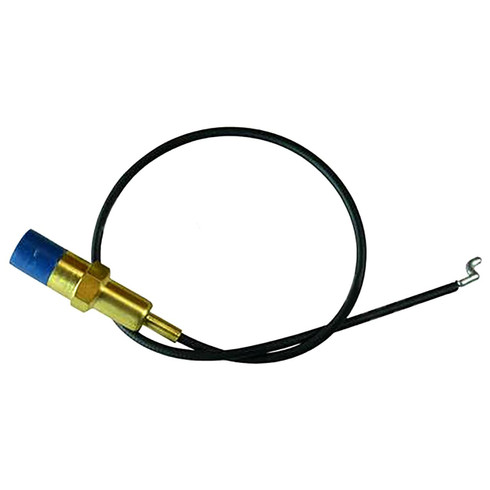

I believe this to be the automatic throttle control cable.
I found the part number for it on SPD,
312503GS​
Looking to be SOL and backorder everywhere.... about to call around a few places.
