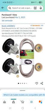

I have a 1045ltx 46" deck that takes a 98.5" deck belt, not the 103" specified.
Belt is routed right but the 103" is too big! What gives???

Sometimes they have different deck pullies and belt according to serial number on the machine. The label numbers are designated by the seller/ manufacturer aka cub cadet in this case. Parts should always be ordered by the serial and model on the manufacturing (usually white) label under the seat or hood.
