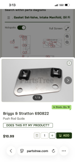

IMG_1953.png Would yall happen to know if just the plastic guide pieces are available separately?
I’m helping my dad over the phone and he’s 250 miles away right now…
I normally replace the entire plate because most of the time when the issue rears its ugly head the push rod has chewed through the plastic guide, and worn into the metal plate to the point that will no longer hold the plastic guide in place and the push rod has been cut in two.
Funny you say that, my dad just sent me a picture and the push rod is worn almost in two… new plate it is.
As far as I know, the plate has to be purchased.
